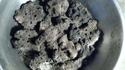

I bought a ton a few days ago (bag doesn't say Elkins or Hope), they are still incredibly hot, but now my burnpot is getting a hard crusty layer on the bottom that I need to scrape once or twice a day.

I had the exact same results with the ton of Hamers I bought this year. This was my first time burning them. The heat and quantity of ash was good, but that caked up layer that coated the burn pot required a scraping atleast once a day and usually twice. It wasn't worth the hassle and I will not buy them again.
Here's a pic of 4 days worth of clinkers from the Hamers. Even though I had to scrape these from the burnpot twice a day, the stove cranked out awesome heat.

I hate that ash cake. That is reason enough for me not to buy a brand that leaves that mess. I don't get them with MWP. I'm too cheap to buy anything over $260 a ton. Got my MWP's this year for $167. ( delivered!)

Seems they might have some fiber with higher than usual chlorides(salt) content. Word out says there is some chatter going around and its not just here. This is what I heard from an insider,
"Some of there wood comes from a mill that pre-soaks the logs in salt water(brine) to rid it of bugs and helps remove the bark. They generally don't use a lot of this, But with the fiber market slightly lean them may have used too much in some batches"

I've found that the hammers simply need more air. They burned great for me wide open damper on lower settings. but on higher settings, there simply wasn't enough air to get the full burn against all the fuel and the clinkers starting piling up.
The above pic was the result of 4 days with the damper wide open and the heat setting on 4 (of 5). As I mentioned earlier, I'm not really complaining because the heat was amazing and it only takes me 30 seconds tops to swipe the burnpot. I was trapped in my house after that blizzard, so what else was I going to do? ;)
