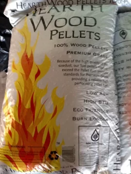

That's good then you have at least decent pellets. And I do believe you. You need to believe me when I say there are crap pellets out there that will fill the huge ash pan in the P61 in less than a week of burning. Just because you have not burned those pellets does not mean they don't exist. And yes, they said Premium on the label and 1% ash on the label. Other , what I consider to be ashy pellets , fill the ash pan in a bit over two weeks of burning that say the same things on the label. That's how it is. Douglas Fir Pellets take over a month to fill the same ash pan. Oh my gosh, what a difference a pellet can make !
All pellets now a days say Premium grade.... that doesn't mean much anymore. What brand pellets are you burning? What's the name on the bag?
Reactions: Jack Morrissey
These are the pellets we have been using.

We have tried different settings on the temp dial. Yesterday, it was all the way up to 7 with the feed rate still at 4 (otherwise the hot ones are falling off) and still my 5 kids were huddling around it trying to keep warm.
