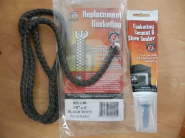

Not familiar with that model yet. Replaced two stoves gaskets this week so far and the phone text is beeping. Picture of the kit. Works very well. Was only $6.50. The adhesive is not RTV and is a bit runny to get a good bite on both the metal and gasket. [Hearth.com] Harman Accentra dirty glass?

Not familiar with that model yet. Replaced two stoves gaskets this week so far and the phone text is beeping. Picture of the kit. Works very well. Was only $6.50. The adhesive is not RTV and is a bit runny to get a good bite on both the metal and gasket.View attachment 144129
That's the same cement I used. It is runny, definitely something you want to try and apply in a flat position "door removal recommended". In regards to where to by it asked by another individual, i've found it at most of the major home improvement stores. Here in oregon we have Coastal farm and ranch stores, who also carry it, so maybe a big farm and ranch stove if ones available.
I used a wet paper towel to moisten the gasket prior to instalation according to the instructions on the kit. This suppose to help the gasket stick to the adhesive. My adhesive was not runny to the point of having to remove the door. I just ran a bead ,press it in and shut the door to seat it and opened the door for an hour. The tricky part is getting a nice square clean joint where the ends of the gasket meet. I put a little extra adhesive at that location to help hold the joint. Cleaning out the old adhesive and instalation of new gasket was less than 1 hour. This is my second replacement so I knew what I needed for tools and the process. This time I put the joint at top center to make it easy to see and work on.
