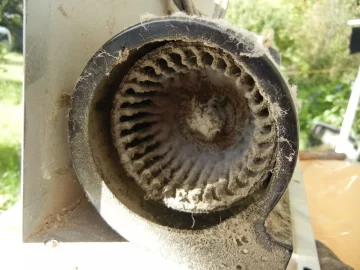

when you open the door, remove the large plate at the bottom below the burn pot by flipping up the two rotating clips. The exhaust pipe will be in the center more or less and will lead directly outside, mine is a diamond shape. I use a 3 inch flue brush that you can add lengths too. You should push this through to the outside pushing out any excess ash. Be careful when going past the ESP (temp probe) you don't want to just jam it through. When you pass the ESP make sure you clean that exhaust area thoroughly. Also, check your door gasket to make sure it's still tight and makes a good seal. I replaced mine after 3 years and did it again today as I am on my 6th winter.
Also, clean the fan blades on the right hand side and vacuum any "crud" when you remove that bottom plate. Make sure the V-shaped tubes on either side of the of the burn pot are clean as well (after removing the heat deflectors).

When you replace it,stuff a blue washable filter around it so it catches the hair and dust. Not the fan blades. You can cut a strip and place it along the leading edge under the valence.
