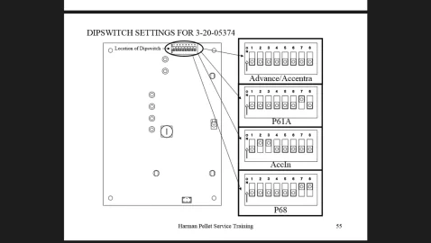

anyone know what the switch settings are for board # 3-2-05374B.ive done a search and seen a lot of posts but none on this particular board.
also,there is no date of manufacture on the stove just a serial #012596.any way to find out the age of the stove.

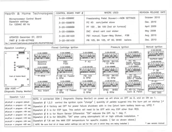

Not sure if this will help...The "B" is missing at the end...
[Hearth.com] harman advance dip switch settings
.thanks again Daksy..so on a harman DDM it would show all O,s on the didital display,correct?
