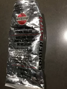

I had the same problem on my Accentra insert. I successfully patched it with an automotive muffler repair cement. I think it’s called Spider Patch. It comes in a squeeze tube that comes out as a thick paste that I forced into the crack with my finger. That was 3 or 4 years ago and it’s still holding. Simple, fast and cheap ($10?).
Here’s a picture of the product I used.[Hearth.com] Harman Advance repair small hole

High temp patch sounds like a winner. I'd plug those bottom 5 firepot holes too. They definitely add more heat near auger which leads to erosion of auger tip and fire burning near auger tube. Also make sure your auger is all there and not shortened by erosion leading to fire in tube area.
