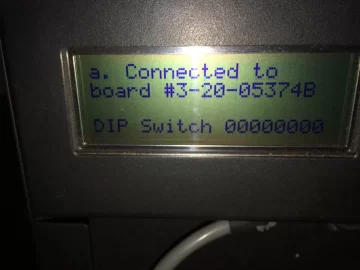

Any chance someone changed the DIP switch settings? 1 through 3 affects the initial fire start feed amount.
You stated the fire is not burning normally after fire started and ran a while which is probably another issue (plugged firepot holes, slow exhaust fan, bad ESP, bad board, leaky door gasket, plugged exhaust...
Dip switch settings are as they should be. All off if I remember correctly. I have a harman diognostic so I can see the switch settings. Pot holes are clean. I use a drill bit to keep em clear. Gaskets are good and new. So that leaves the esp and board

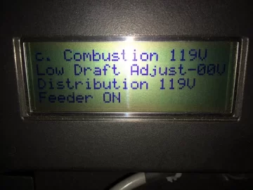

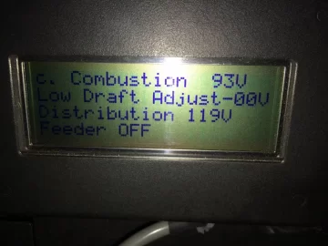

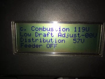

This is what the DDM is showing in test mode. The auger is a 4 rpm and it does spin 4 times a minute
I also emptied the hopper and could see the slide plate moving. It moves about 3/4inch
