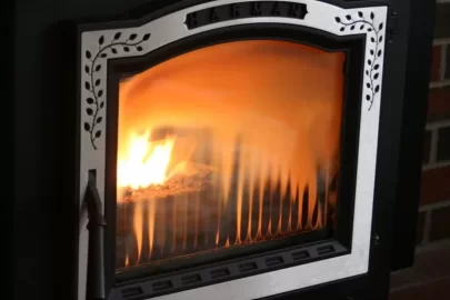

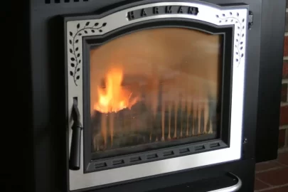

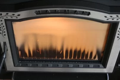

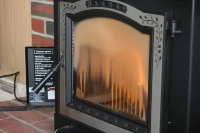

Here is a picture of my Harman P35i insert showing the "burn marks" above the air wash holes and the amount of ash build up after two days. I thoroughly cleaned the glass two days ago with Rutland glass cleaner and this is what it presently looks like. It gets worse and after five days or so you cannot see inside. Someone mentioned if there was a draft test conducted during installation......there was not and the dealer told me it was not needed that this was done at the factory. My pellet insert is new....it was just installed. Any comments about the glass door? THANKS!!!

I had the same problem, and at least in my case, I figured it out. Above the burn pot are two removable plates. One on the burn pot itself, and another above it called a flame guide extension. The extension can be positioned forward, or back against the rear wall. Mine was forward, and I always left it that way because that's how the installer left it. PUSH THE FLAME EXTENSION GUIDE BACK AGAINST THE WALL, AWAY FROM THE GLASS. Once I did so I noticed the ash blew up instead of forward!

Mine does the same thing I clean it with a wet paper towel on my 7 day cleaning with it off and the glass not hot.
brown/grey ash buildup on glass is a perfectly normal thing for all stoves.
It's a known occurrence with the P35i and have just learned to live with it. Ill typically clean it every time I dump the ash pan, which is every 2 weeks or so.
Just wanted to post a quick update. My flame extension guide kept working its way back forward every day. For weeks I just lived with it. Today I tried looking for videos that show it, and couldn't find any. I started looking at the install section of the manual, and found that my extension plate was backwards! (Top edge pointing to ward the glass.) I flipped it around, and that seems to have made a much better fit. My installer screwed up when they set it up, and stupid me, I trusted them and never looked in the book. Make sure the plate curves up, not toward the front door. Hopefully, not everyone is as dumb as my Harman installer and I!
