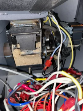

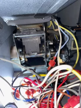

Fines box? You talking about the metal guard that exposes the auger from the side and a usually a lot of pellets and dust reside after time? I always clean that out during major cleanings. I apologize I looked all over the place online trying to duplicate this sound and found nothing yet. If you have a link id love to see it. Thanks Sir!
I would clean that out during every normal cleaning if possible. On mine I can remove the control card and then it's easy.
Yep that's what I thought you were talking about. I do the same. This year I even put some graphite powder in the auger to aid with dry lubrication.
