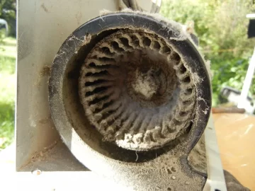

Owner wasn't getting any air out of this either.

soon as I seen cats, take it off give it a good cleaning. It is amazing how much gets sucked up in there
Well, after another brutally cold night I waited until the house was warm enough from the sun this morning and powered down the stove and waited about an hour. I took the shields off the back and the wheel on the blower is still as clean as a new one. I decided that's it and took the blower off pretty simple if you have a long extension with a swivel. Once I took the blower off it was unreal. I could hardly get my hand and fingers in the square hole. Facing the back of the stove I pulled out a huge ball of burned cat hair on the left side and the same on the right. I used a coat hanger and a fish made from electrical wire. I cleaned everywhere I could get them to go. I think that I must have had at least a softball size ball of disgusting cat hair that must have collected in there for the last 6 years. I can tell you it feels like I have a brand new stove again. Now I am back to being too hot sitting about 16' from the stove. What I am going to do is use the outer ring with the 3 screws and put a small mesh screen over the intake of the blower. I would rather stop it before it gets in the stove.
