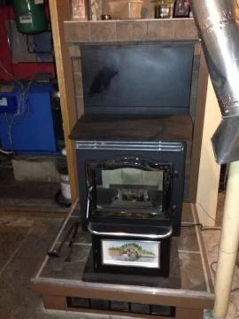

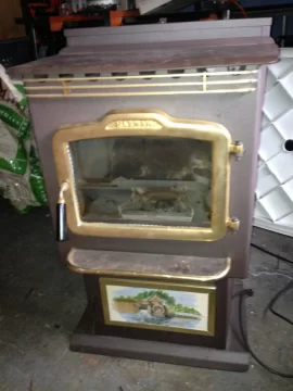

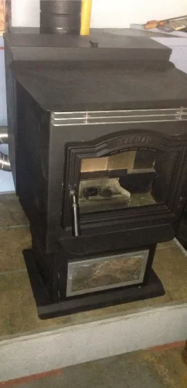

Hello
Congrats on your Nu-2-Yu Harman. :)
I picked up 3 "new to me" Harman P61a and sold one to pay for the other 2! Anyway, I have then both downstairs and with a combo of 120 BTUs they should heat well in this 2 level split.
My question is what type of house do you have and where is the location of the stove? Location is very important!
We have many options on controlling these babes.
Stove Control
1. Stove Temp mode - a good option especially for those cold winter days when it should be on all day.
2. Room Temp mode - good for the fall and spring when you want the stove to shut down on mild days where no heat is needed.
Remote Control
3. Wired T-Stat - Such as Lux 1500u from Lowes with the "Swing = 2" which is made for pellet stoves.
4. Wireless Skytech T-Stat such as the Sky-1001TH-A -- you can move to any location for more comfort.
5. WiFi T-Stat such as an Ecobee Smart-Stat such as EB-Stat-02 for Smart Phone control anywhere!
In options 3-5 the T-Stat must be connected to one leg of the room probe and the stove must be set on room temp mode on a setting higher than what your t-stat is set. Example set Harman control to 95 Deg F and then your T-Stat will control the temp when setting it to 70 or 75 Deg F for example.
I have not completely decided which way I am going but may try a few of the above options.
The Harman Stove controls work well and many people use them. There are also some members here who do use a T-Stat and feel they save even more pellets when using the programmable Set Back feature by turning the temp down at night.
So let's try some and compare notes?
Also we like to see some pics of your stove install?

Don, I notice duct work to the right of one of your pictures. Do you have this model piped into your ductwork? If so, how well does it work?
Piping any stove into ductwork can really help distribute the heat better. At first I tried just having the ductwork over the stove and measured 80 Deg coming out of the register upstairs. Then I brought the ductwork down to the front of the stove and measured 130 Deg out of the kitchen and livingroom registers so the heat is more even between the upstairs and downstairs.

Anyway, it may be worth a try with the Harman too!
It may not be within the town fire codes but the codes vary so much. Some tows say if the ductwork is securely fasten to the front of the stove, then it is ok.

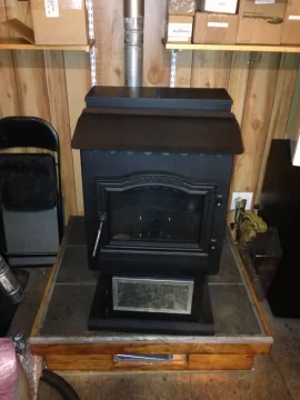

Good Question.
There are exactly 4 models
The following models have the old style Fire Door.
P61 - Manual Lite (Old ash door and ash pan)
P61a - Auto Lite (Old ash door and ash pan)
The following models have the new style Fire Door.
P61-2 - Manual Lite with new recessed ash door so the the decorative tile is flush with the front. (The ash pan is thinner also)
P61a-2 - Same as above but with Auto Lite
Hope this helps.
Pics are of the same stove that I re-incarnated ! ! ! LOL
Pic1 below is old P61 or P61a with old fire door and old ash door with optional surface mounted tile frame holder.
Pic 2 below is new P61-2 or P61a-2 with new fire door and new recessed ash door with recessed tile.
Also has optional nickel trim kit and hopper extension

Looking at your pictures, my stove (purchased March 2009) has the new fire door, but hard to see the difference in the ash door. So based on that I have a P-61-2, although my dealer never referred to it as that, just P-61A.
Yes, it is a P61a-2
The tile sticks out in pic 1 - There were problems with them falling and breaking!
So in pic 2 - the tile is recessed and cannot fall and break!. In order to close the ash door with the new recess, the ash pan is slightly smaller. LOL
