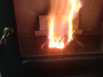

Finally, at feed rate 2, I'm getting a nice big flame. It's blue at the bottom and almost touches the heat exchanger. I either get ash build up like in the picture or pellets falling into burn pot.

Did you replace the flame guide or the fire brick? I can't see the flame guide in your picture. Is your room temp senor hooked up?
I would at least shut the stove down and clean that ESP probe and start from there.
Also isn't the P61's supposed to have 3 fire bricks standing vertical? I only see one laying horizontal.
Where in PA are you located?
Good catch MT ! I didn't even notice those things. Yes it will not burn right without the flame guide in there. And yes it takes three vertical firebricks.

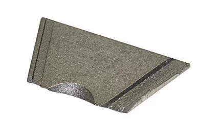

This is the flame guide that should be there sitting on top of the sides of the burn pot:

I had forgotten to reinstall the flame guide after a cleaning myself and wondered why it wasn't burning correctly.
We had a guy visit us in the forum a couple of years back who bought a used P61 without the guide. He had similar issues to the OP, not sure about feed rates but ash and pellets everywhere as I recall. He bought a guide, installed and all was well. Now understand that I can't remember putting my shoes on in the morning so the details of that event might be fuzzy !

Yes, bought a new flame guide. But it's not curved, it's straight. The old one was cracked in half, and fell apart, but it was curved. All the guides online for the P61 now are straight, just thought it was the right one. I was also wondering about the bricks, however the owners manual says a "fire brick" is enclosed. I went to a Harman dealer and they had one brick in the floor model.
I mean, am I overthinking this? Or do you guys agree, it should run on feed settings 4-6 without dumping pellets; right? It should be hot as h***, but it should run though. I can't image the amount of pellets I would dump on setting 5 or 6.
I mean, maybe it's the flame guide. I changed that out and the door handle this past weekend and it seemed to go South from there. The door handle wouldn't keep the door tight, and I could see gaps by the door gasket. I also guess more bricks won't hurt, so I will get some more of those too.
