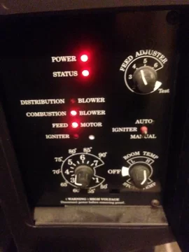

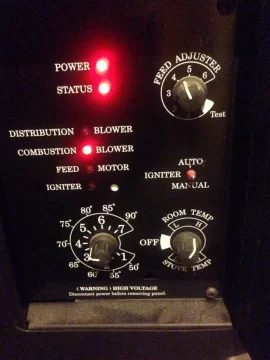

There seems to be another case where the Distribution blower can be off in Room Temp mode!. This stove below has the newest circuit board so it may not be true for older circuit boards
When running Room Temperature mode and the switch is in Auto, if the temperature of the room is just 2 Degrees above the set point on the stove (2 Degree upper Swing), the room blower in this case will turned off automatically only if the fire is at it's lowest setting! I did not see this happen on the colder days when the fire was ramped up! ! !
Example:
The fire was still going and the auger was still feeding pellets at the min rate in pic 1&2
See Pic 1 -- Room Temp on Digital Thermom is 72 Deg F
See Pic 2 -- Harman P61a-2 stove temp dial is set to 70 Deg F and only combustion blower LED is on and only the combustion blower is running.

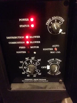

When I turned the temp dial up to 72.5, just above the room temp on digital thermometer, the distribution blower and it's LED came on!
See Pic 3
When I turned the temp dial on stove back down to 70, the room distribution blower and it's LED went off.
See Pic 4 and notice the pellets are still feeding at a min rate becasue the auger feeder LED is on and I hear it still feeding.
Note: If the stove temperature dial is set any lower than 70, the stove goes into shut down mode. Therefore it looks like a 2 degree bottom swing programmed into the chipset.
