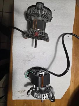

Thank all of you for your help. We were able to determine that the problem was the combustion motor and we were able to buy one from a Harman dealer. However, the new motor on the right with the same part # 3-21-08639 seems to be missing some parts as compared to the one taken out of our stove (circa 2008). Has Harman changed the design and if so will the new design work on our stove?
