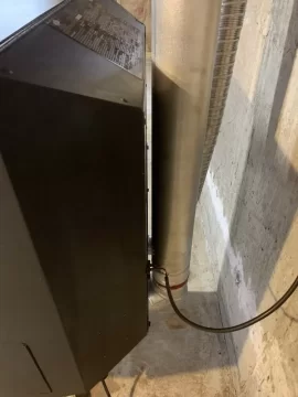

For some reason I didn't notice you have a P68. My P61a has a 45* elbow off the adapter so the pipe angles away from the back of the stove anyway. My exhaust doesn't go straight up. but at an angle for the vertical rise (placement of the stove is offset from the basement window it exhausts thru). The good thing about the 45, is it helps maintain a decent distance from the wall, so I have plenty of room to work back there when needed.
That exhaust is a couple of inches away from the wall at the top - the angle and the shadows make it look too close.

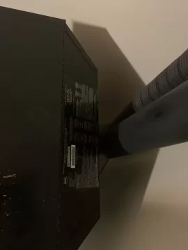

Update. Been running the stove this weekend with pipe approximately 1/2” from rear of stove. All seems good. Inside of hopper is cool so it doesn’t seem to be an issue. Now I need to figure out why this thing is gulping pellets and won’t cycle down.
