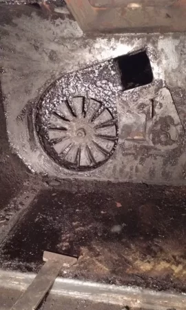

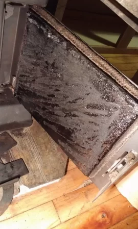

Hey everybody! My name is Deric. I am from northern MN, where I just purchased my first home. It is a small log cabin on a dead end dirt road, about 15 minutes away from the city.
Anyway, this new home of mine comes with a Harman P68. I've done plenty of research on the model and pellet costs and how to survive the winter. I imagine I've still got plenty to learn when it comes time to fire this thing up and maintain a warm house too.
Tonight I decided to clean the stove according to the How-to videos provided by Harman. I expected this stove to be extra dirty considering the house was a rental for the last 3 years. However, I am not sure this is normal. I'll attach pictures below so you can see what I mean. Maybe this is normal for a pellet stove, but my gut tells me it's not right. This stuff is hard as rock and glossy black. I can hardly scrape it off. Its really bad in where the fan is located. Is it worth fighting with or should I just leave it?
Any advice? Thanks in advance!

Congrats on the new house but I feel very sorry for the P68. That is definitely not normal. Do not use it until you have the creosote removed and check out how all the components function. I think this spray is a good one but likely can only get from a stove shop. The amazon listing is for 4 spray bottles so it's not cheap but then neither is a new Harman;sick Likely the venting is a mess too. Is the stove still in the house or out in the garage while you are working on it?

The creosote is a product of incomplete combustion which could be caused by a few things but is most likely an airflow issue. If the stove wasn't cleaned for a long time that would probably result in creosote buildup. An issue with the venting could also be a factor. Burning damp pellets or other fuel is another potential cause.

I would suggest you get a heater to keep the chill off as a temporary measure. Creosote is highly flammable (cause of chimney fires) so you need to get the Harman cleaned up. You are way beyond simple maintenance. Always unplug the stove when working on it. Not sure of your mechanical ability so you may decide a stove shop should do this for you...

Like everyone else has stated, don't use stove until exhaust is cleaned out. Odds are it's plugged resulting in poor flow and cresote build up. Also be careful scraping around exhaust fan as blades bend easily. If it was my stove, I'd try again post cleaning to see if it achieves vacuum and feeds pellets, lights etc.
Did you replace cover ovev exhaust fan on your failed second attempt at starting it? That may explain the no start due to no vacuum being created in burn chamber.

When I run it on TEST mode, both fan lights are on, I can see the lower fan behind the ash pot spinning, and I can feel the motor on the rear fan is working. But which one blows through the ash pot? I have no flow through there even though the holes are clean. There was flow last time I lit the stove, now there is nothing. What would cause that if both fans are still working?
The blower behind the ash pan is the exhaust blower. It draws air through the burn pot and sends it out the exhaust venting. While the burn pot holes may be clean, other connected passages may not be ... From your photos, it is apparent that there is an airflow restriction causing creosote. May just be extreme ash buildup in the exhaust venting... could be a critter like a dead bird or chipmunk. Is there a screen on the exhaust vent termination outside? Is there an outside air kit attached?

But, new information. I've been running it on test mode trying to diagnose. I put a piece of news paper over the holes in the burn pot without any pellets. When the stove is sealed up, nothing happens. When I crack open the hopper lid I get slight, but constant, air flow throw the burn pot. As soon as I shut the hopper lid, the paper lays back down with no airflow. Bad window or door gasket maybe?
It may be more an issue of blocked flue. From the look of the door, you should replace the door gasket anyway. Have you run a brush through the venting? How is the venting set up and does it have a clean-out T?

Opening hopper creates air pathway bypassing plugged intake. Check for stuck closed air intake flapper, or if you have outside air u may have a bird nest in duct.
According to the cleaner, the vent was basically blocked shut. He cleaned it all out and cleaned the whole stove and still nothing worked. He ended up fiddling around in the back side and found the flap for the intake that was stuck shut. He popped it open and cleaned it out and everything works! I feel stupid that it was such a simple issue, but the stove needed cleaning anyway and now I finally have some heat on the lower level. Thanks for everyone's input, such a helpful group :)
