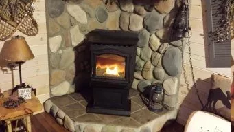

ctown, I think the real problem is judging by your avatar you have your stove installed upside down LOL!!
Reactions: bogieb
Lol I can't figure out how to flip the damn pic
Try this.

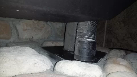

You want a picture of my direct vent outside of house?
Well if I find that the air intake is higher than the vent termination that picture isn't the only thing that is upside down besides you might have a bird hanging out of it gumming up the works.
ETA: I am always looking for things that allow me to (see last line of my signature) preach from the good book.
My chimney is lower than cold air intake in the house
Outside picture please the goal is to provide air flow in the proper direction and having the outside configuration backwards doesn't help the mater although a minor difference in this case usually doesn't lead to major issues since the system is still under the control of the stove's combustion systems unlike the gasket situation.
This can however cause issues with a power outage situation and depending upon the separation distance to the vent termination lead to oxygen depleted air being used for combustion never a good thing.
