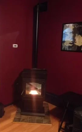

And the super pixelated stove pron picture.
