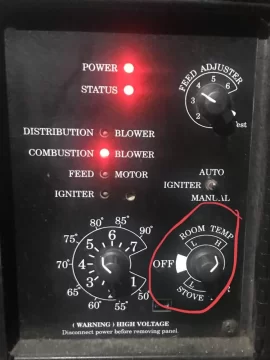

On the control panel, bottom right knob
It'll purge the pellets in the auger, but should shut down after awhile
Don’t flip the switch, turn the knob to the off position.
Reactions: Washed-Up
Try turning it to off and turn the feed rate and temp setting all the way down
Turn that dial to off position . Harman's are known to be slow to react when shutting down but it is possible you need a new switch. They are a potempimreter only spelled correctly. But are known for wearing out and needing to be replaced. I read about a new version of that swich that is on E-bay. Anyway they are reasonable in price and can be installed by removing the old one and installing the new one.
When you turn that dial to off it is normal to be slow to shut off and exh fan will run for several hours.
Agree with all above, also, on mine, when I turn the dial to "off", the "status" light goes off. And then yes, it still feeds very slowly to purge pellets and takes a good 30 mins or more for it to be fully shut down and fans off.
Reactions: Shoe0402
Yep, turn dial to off, don't touch the feed rate or any other dials or controls as others may mention; it will take awhile to turn off sometimes 45 minutes, but the fire will continue to get smaller. I doubt you have potentiometer problems, mine are the originals & they're 20 years old.
