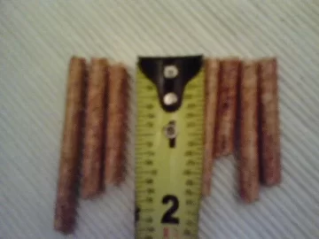

These were some pellets that ran through mine last year with no issue..

I was told the pellets were jamming the feeder, not allowing them into the burnpot. When I receieved the 6 blink status, I would turn the stove off and back on again. It seemed to me that the pellets were feeding fine when I turned it back on.
Just received another 6 stat, turned it off and on again, burn pot filled with pellets. I'm totally frustrated.
