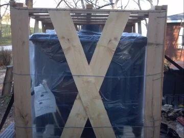

Your right about that! And I'm the silly husband spending hours on end trying to find a stove she'll feel safe with. Thankfully it wasn't just the looks that made her like the Mansfield, it has a good sized drop in the front that took away her fear of coals falling out when she opens the door.and its deep enough to load n/s which we both like.
Now I just have to figure out how to get it in the house.

A couple friends would help. Get a good pair of hump straps for the final positioning.
