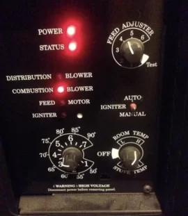

Could you post see t a photo of your setup? And yes running it on stove temp at4 and 4 on your dials will help, I do that to my stove weekly

Is 4 and 4 full for you? My "stove temp" goes to 7 and feed rate goes to 6. Should I do 7/6, or are you suggesting 4/4? Also - how long do you do this for? :30?

Yeah 4 feed and 4 on stove temp should do it, I’ve never run my P61 on max settings, in the photo, the stove tem should be all the way down to the right

Cool. My knobs are same, but in different places on my XXV. I'll do some 4/4 burns once a week going forward.
