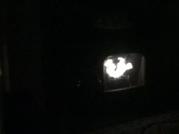

Here's a shot from my web cam on our Accentra... Set on Room Temp @ 70*...
  • [Hearth.com] Harman XXV flame
John193... I "normally" only get the flame touching the glass and curling out to the sides when I'm starting the stove and do have it on a higher setting. To maintain my house comfortably once it's up to temp, my settings are: Room temp mode, Feed rate usually in the 3.5 to 4 range with the Temperater set around 72°F and the flame is tall but remains behind that upper shield. Does your flame stay like that consistently?
