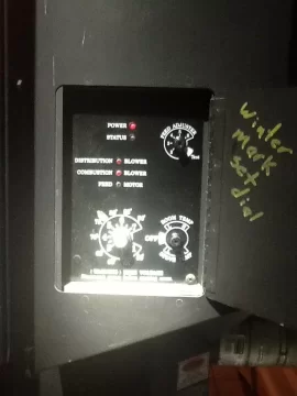

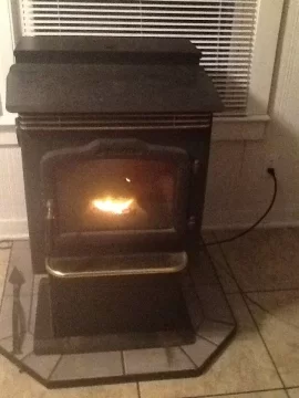

We just moved into a home that has the Harmon P61 pellet stove. When we turn the dial to the off position the fire dies down but doesn't go out because the pellets continue to feed just in much smaller amounts. (Fire in pic is about twenty minutes after it was turned to off position).
We also notice that the status light is blinking twice. Maybe related to why it is still feeding pellets?

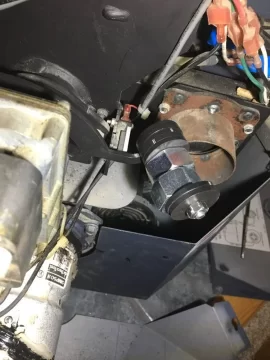

I had same problem. Fixed it with suggestion from another p61 owner.
On the arm in the back that is engaged by the cam wheel when the auger runs are some weights. They should hep lower the arm fully when the cam wheel comes off of the arm. Thus allowing the weighted arm to press on the micro switch just below the weights. I guarantee the arm isn't fully engaging the switch. This also causes the 2 blink fault.
Simply, while stove is cold/off, add some more weight to the arm. I added a couple 1/2" nuts and a longer bolt, other people have just added more washers.
I also sprayed a little high temp dry graphite lube on the pivot point.
Problem solved. [Hearth.com] Harmon P61:  doesnt stop feeding pellets when turned to off position
