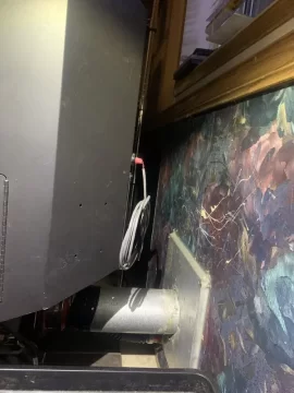

Stove is 1.5 years old, purchased new. End of last year problems started. Set temp on 70, room temp reading kept going up, way up, fire continued to burn big. Repair guys changed everything, mother board...twice, piping, position of stove, temp probe. Worked for a few days, then back to see old issues. On this forum I read about cleaning temp probe, no one mentioned this to me. I did that and stove worked fine. Now, still having temp issues. I clean probe every time I clean stove, 2-3 weeks. Set temp on 70, room temp reads 74-75, fire doesn't really cycle down. Room temp probe is taped to stove cord on floor...repair guys idea. So...isn't the fire supposed to cycle up and down depending on temp set? And if temp probe reads room is hotter than set temp should not that signal stove to cycle down????
The floor will tend to be the coldest place in the room. If the stove is attempting to warm it up to set temperature it will way overshoot what you wish at higher parts of the room. I once had my thermister fall from its normal 5' high location to the cold stone threshold. The room set a new all time high temperature before I figured out what had happened.

This set up keeps my place 5c within the dial setting
