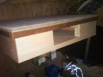

Hello
On my second raised hearth, I am cosidering slate tiles because of the rich colors.
Has anyone used slate? Do they wear ok without flaking and chipping?

Nice looking raised hearth by the way Don. I wanted to do mine raised but my wife didn't want to. And of course she wins... but i'm happy, i like the way it turned out.
Thanks, The raised hearth makes the stove look bigger. :-)
Also I framed an openning that I may put a small hinged door on to store tools like the pellet vent cleaning brush and other stuff. :-)

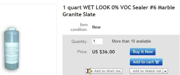

I used slate tile on my hearth. I haven't had any issues really. I had a few flakes after installing it but it's not a smooth surface so you don't even notice.
I applied a "wet" look sealer which should help out with any wear or stains. http://www.ebay.com/itm/1-quart-WET...ultDomain_0&hash=item3ef175b2f0#ht_794wt_1163
Oh, very nice thanks for the pics too!
I really like the idea of a wet look sealer. Does it need to be re-sealed every year?
Since the slate doesn't get foot traffic I wouldn't think it would need resealing yearly. I applied 3 coats on mine, the slate really sucks it up.
I have also used the stuff below on a slate floor I once had, it works well too and has a "wetter" look.
Also, if you haven't already noticed, slate tile is really cheap. I think all my slate for my hearth was $30.
