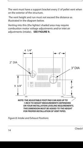

Got the old stove moved out but have not received the Serenity yet. Planning the hearth, I have stove dimensions and exhaust location, but I need to know if the exhaust protrudes from the back of the stove or is recessed (or even) with the back side of the stove. I realize this would only be a variance of a few inches but it will help me plan a tile hearth that looks right.

Not at home to take a measurement but from a pic it looks to stick out about 2"
ok I measured it and it's 1"

Hey there I ordered a serenity as well and I want to get the venting installed in the meantime. I wasnt able to find the dimensions for the measurement of the back Venting pipe. Any help would be appreciated. Thanks
Go to the (broken link removed to http://www.castlestoves.com/serenity-wood-pellet-stove) and you'll see an icon for operators manual pdf. If you rather not click on links, I simply googled "caste serenity manual" and scrolled to the bottom of the page to where it says product documentation. Inside the manual you should find all of the install dimensions and venting designs.
