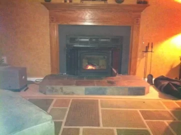

I used the steel studs from home cheapo and put them 12'' on center in a grid pattern and then 2 sheets of cement board with micore sandwiched between. I used thinset between sheets, I finished it with slate tile. Very solid and granted I only have an insert on a small part of it but I would wouldn't hesitate to put a stove on it if I needed to. Heres a crappy cell phone pic.....
