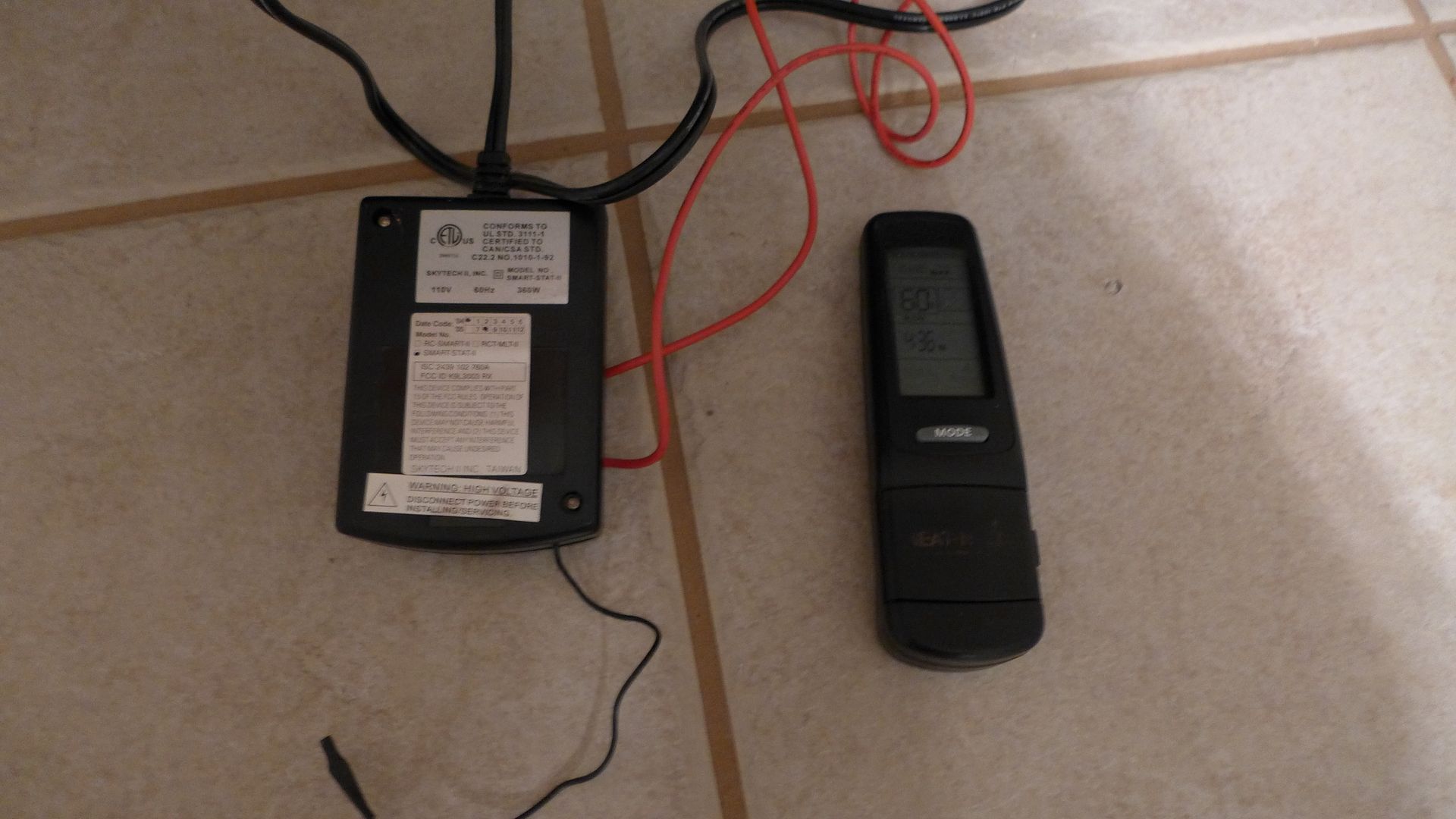

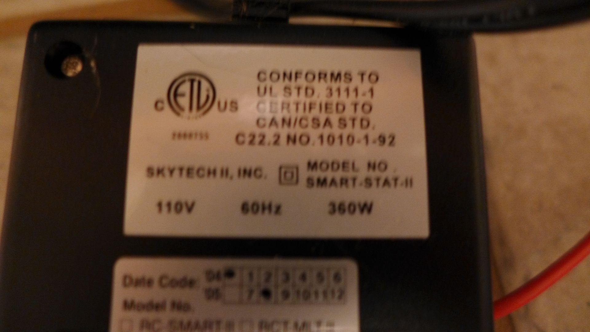

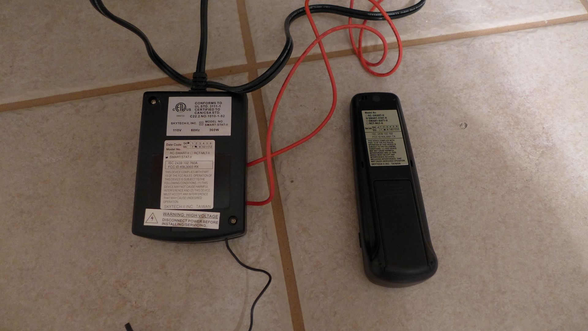

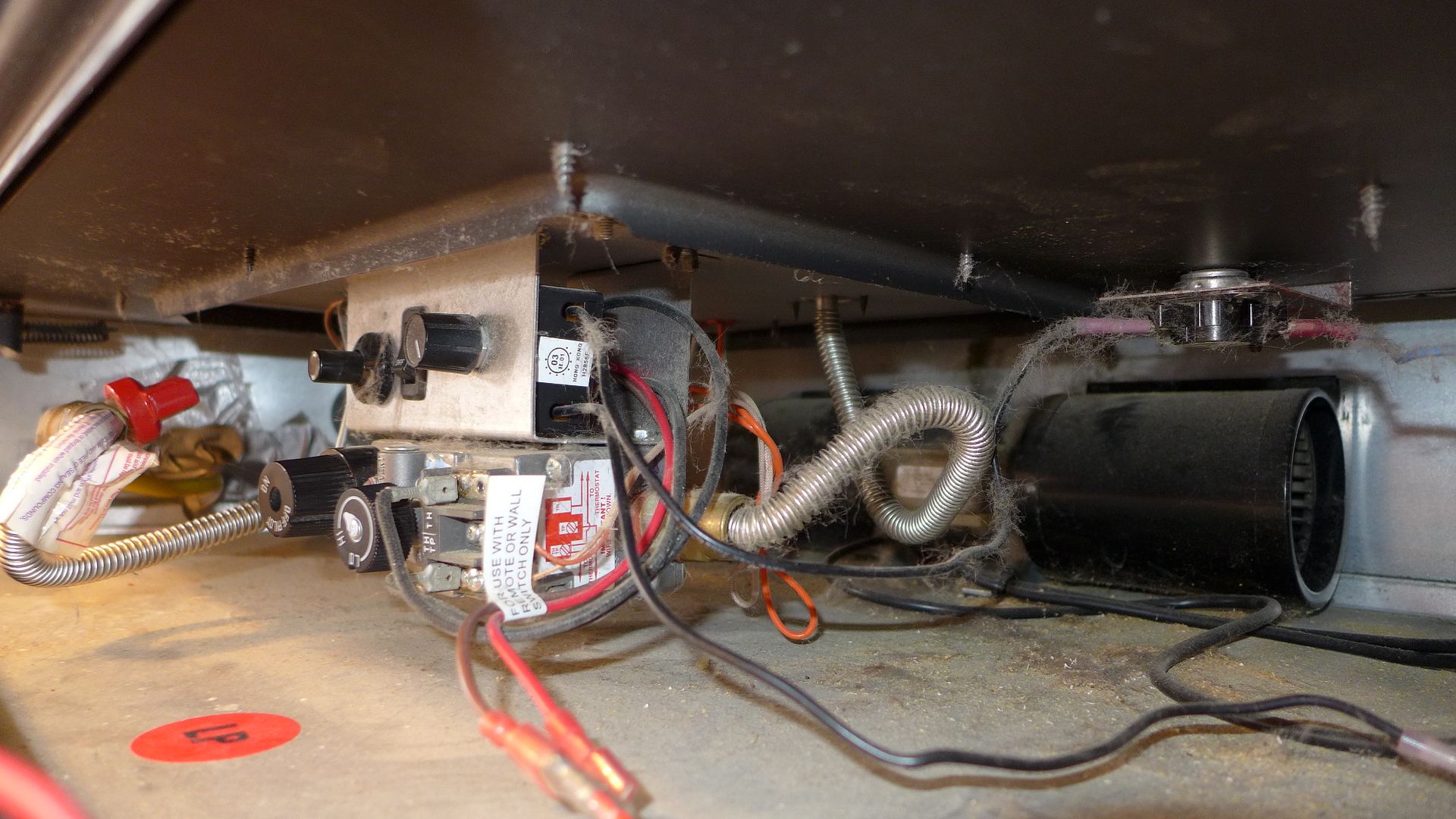

Well...that's what I was hoping; that it was as simple, as batteries in the receiver as well. But when I checked it...it actually plugs in. Here are some pics. Is it possible, the receiver still has batteries that need to be changed?

No batteries in the receiver. Where is the audible "click" coming from? Is it the gas valve or the receiver?
Are the connections to the valve good? If they are, the receiver may be on it's way out. Looks to be about 5 years old...
Daksy, this is where you start to lose me (doesn't take much). I can only assume, these are the connections to the valve; as it's all that's coming off the receiver.

Again...beyond my capabilities. As for the receiver...I can only assume it's original equipment. House is 10 years old now, so my guess would be it's close to that; if not every day of it. Is it likely time for a new one?

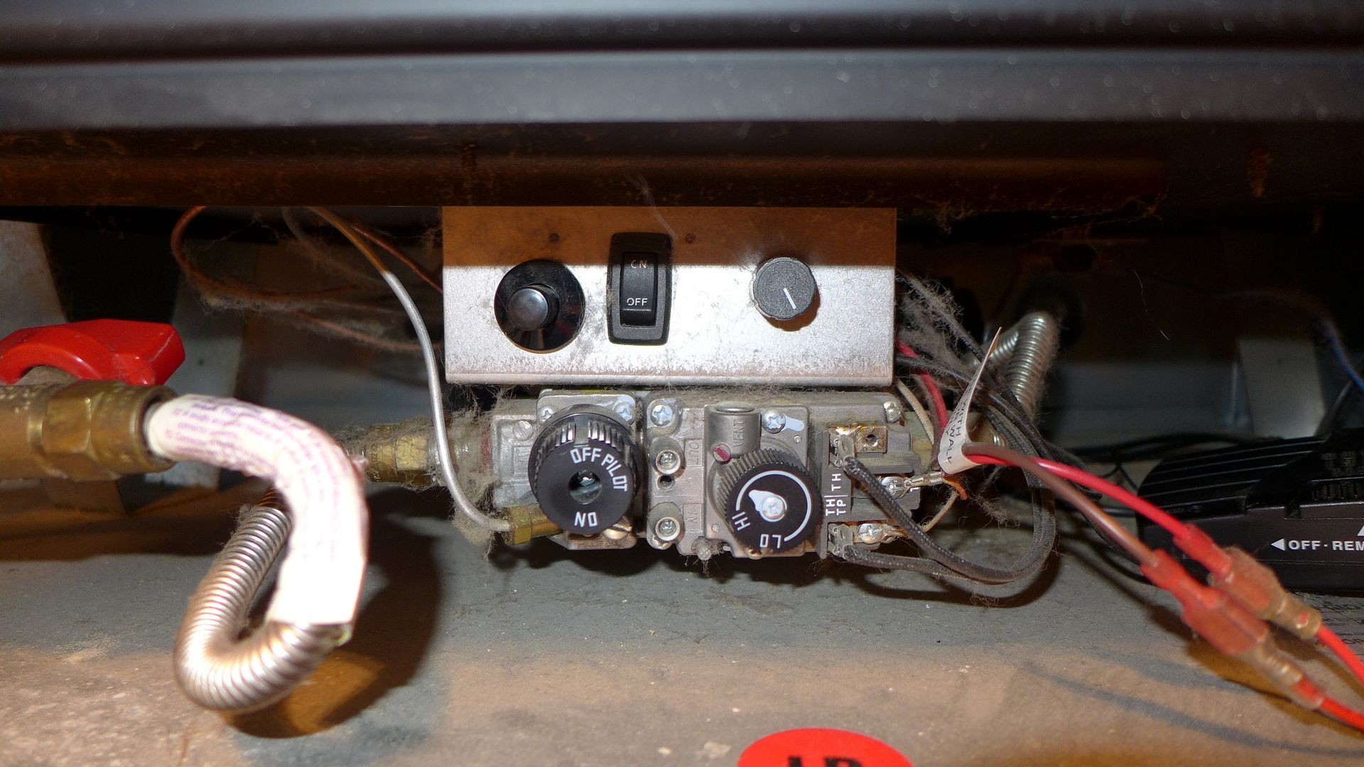

If they're that tight, the connection is probably good. The receiver may be on it's way out, like I said earlier...As far as the blower goes, sometimes the thermo disk is by-passed when there is a remote. Look under the floor of the firebox, to the right of the gas valve & see if there is a wing nut on a stud holding a bracket to the bottom side of the floor... It should be a metal U-shaped bracket with a couple male spade connectors. Maybe 3" long x 1.5" wide...Not talking about the silvery bottom where that red LP sticker is, but maybe right above where I can see the remote receiver in the bottom pic...If it's there, it should be wired in between the blower rheostat & the junction box on the right side wall...If I'm talking above your level of capabilities, you might be better off calling in a tech...
The pigtail that the remote reciever plugs into the brown and red wires unplug them there and go straight to the top and bottom terminals on the valve .This will tell you if the reciever is good or not.That pigtail on the back of the switch above the valve is a common fail point.

Xtordinair, let me see if I understand you correctly: you're saying, find where the pigtail goes up to the valve; and instead of plugging the receiver into that connecting pigtail...pull that off the valve, and just connect the receiver right to the valve? If so...do I have any electrical or current issues to be concerned with? Remember...fish out of water here; don't wanna get burned, electrocuted...or blow something up, lol.

yes unplug the red wires from the receiver that hook to the brown and red wires that disappear behind the gas valve.Take the red wires you just unhooked and connect them straight to the topo and bottom terminals on the valve.There is only low voltage going to the valve through those wires you will NOT be shocked or blow anything up.

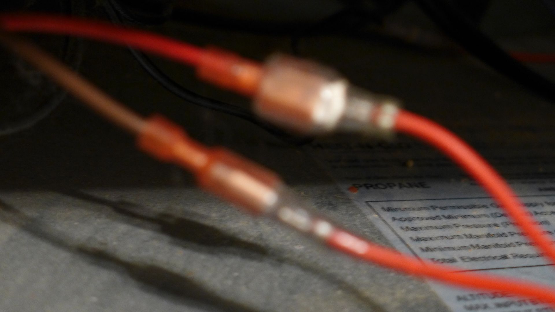

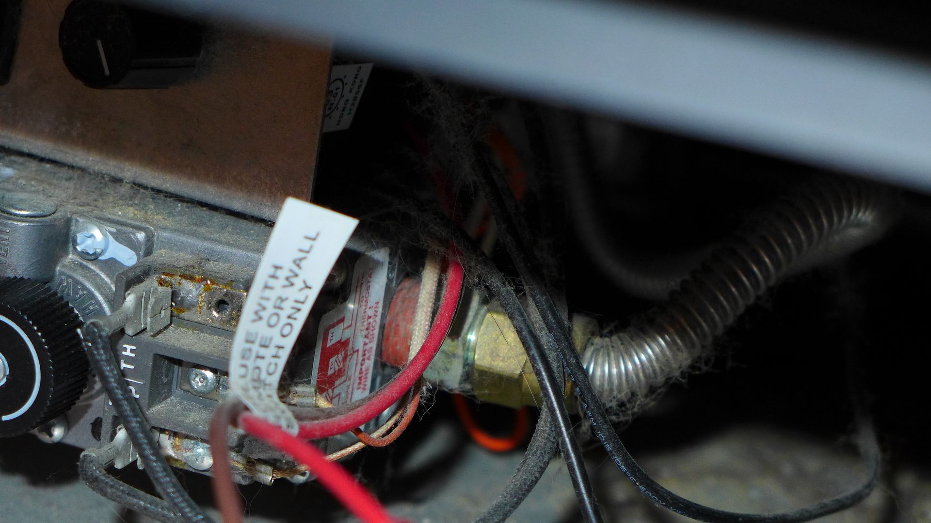

Xtrordinair, thanks. I gave it a shot, but I don't think that is happening. As you can see from this pic...that pigtail is connected, wayyy inside that assembly. My hands are as small and slender as they come...and even I can't get in there. Even if I could get to the leads...I'd be trying to attach the ones from the receiver "blind". Not sure how anyone could do it really...unless there's a way, to pull that assembly out. Thanks
[Hearth.com] Heat N Glo 6000TRLP Newbie Needs Help!
^^^ OK, sorry; I just assumed I was plugging right into where the red/brown pigtail connected.
OK...there are 2 red wires off the receiver; so I can't really tell what goes where, except what was plugged into red and what was plugged into brown, off the pigtail. Which wire should go where, on the valve? They are marked TH (top) and the other TH/TP (bottom). Thanks
Wow; I haven't gotten very lucky with this. That's not going to work Xtrordinair. It turns out...the wires off the receiver are one male, one female; whereas off the front of the valve there...are both male. Drats!

the male terminal that you cant just plug right into the valve ,you can take anything metal like a paper clip or a piece of bare wire whatever and touch the male terminal with one end and touch the valve terminal with the other end .Just something to make a connection with.Its not meant to be permanent .
OK Xtrordinair, let me tell you what I did. I took the female lead of the receiver, and hooked it up to the 'TH' lead on the valve; and I was able to take the male lead of the receiver, and maintain contact with the 'TH/TP' lead on the valve. While doing that...I tried to use the remote, to start the fireplace and it didn't work.
