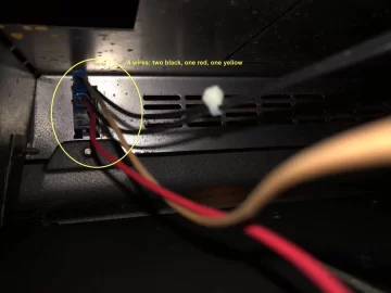

Hey Dansky...finally looked at the toggle and wires...I definitely need a new one but in looking around, all I could find is an off/on toggle switch with 2 wires, plus the tag on it says "for remote or wall use only".
Not sure if this will work, mine has 4 wires coming out. Any suggestions?

That switch should work.
You have 4 wires coming off 2 spade connectors.
Just plug the switch in in the same way as the OEM.
