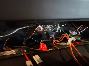

Can you post pictures of your valve
So yes it will work to swap that out with a single pole switch, but... You will lose flame height control. You are going to lose flame height control, lights if you have them, and blower control of you have them. So you are going to have to replace either the regulator on the valve or the complete valve, somehow rewire the lights or just eliminate them, and rewire and control the blower. This is not difficult if you know what you are doing

It would be a whole lot easier to test your pressure out test port first

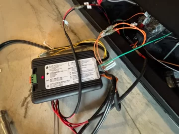

I’ve ran into the same issue where the wall switch has gone bad and I want to replace it with a simple rocker switch. Did you eliminate the control module box and if so, could you please provide instructions on re-wiring? I believe I need the 060-521A. I have no lighting, no fan, no extra accessories. Just on and off. Hi and Lo. I want to keep the flame setting on lo because it doesn’t get too cold here in SoCal. Thank you

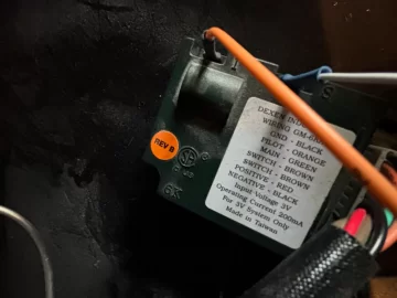

3v adapter, dexen board (you can probably use the one you have) dexen manual flame control valve, and wiring harness. The board says right on it where every wire goes.
Thank you for the helpful info. I’ll look into this. The replacement multi-function switch is over $100. My local heat n glo rep said I could purchase a WSK-21-W which is a basic on off switch, rocker type. It includes wiring instructions and the cost is about $35. So I’m going to look into this as well.
I use regular $2 wall switches and have never had a problem.
It has a dexen board and a 3v adapter already. I’m assuming I’m going to have to remove the useless control module? Would I be using a simple low voltage wire from the switch to the dexan board or a standard romex type wire?
I'd use the wire already there if you were happy with the spot it's in.
Thank you for the coaching! I eliminated the control module and multifunction switch with a simple on/off rocker. Kept the low voltage wire from the multi switch and used only the dexan module. Works simple and easy. Only downside (no problem for me) is the option for hi/low on flame height. I really appreciate the help!
