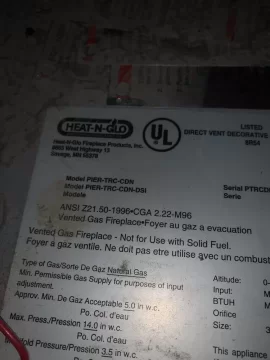

Yeah, it’s an old one for sure. I’ll have to read up more on the terms, but this attached image is what the name plate says. It does have a constant pilot light, and maybe I used the wrong term DSI, as it is the second listing under the model number.
Thanks

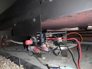

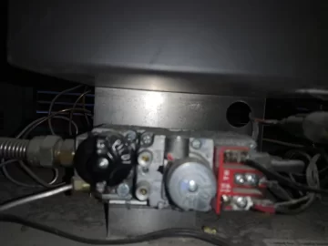

Tracing by the wiring, it seems like the wireless thermostat sends the “on” or “off”signal to the receiver, then the receiver sends power to the control and the fireplace reacts to that input.
I’m assuming the newer controls are different? Still learning, thanks,

You should be able to use any milliVolt remote with this item. It is NOT a DSI unit.
Skytech is a popular remote mV t-stat.
