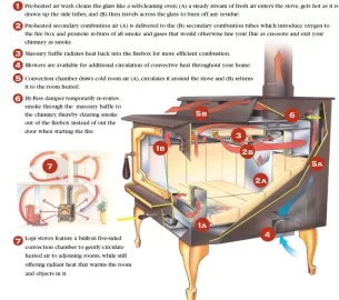

My Lopi Liberty came standard with side & rear heat shields, and I ordered it with the optional blower kit when I had the stove installed back in 2007. I love it. The heat shields are effective in developing natural convection around the outside of the firebox to help distribute the stove's heat, and the blower is very effective at providing forced convection of air from beneath the stove up and out through ports below the top plate of the upper shelf. The blower speed is infinitely controllable between its minimum and maximum, and I can shut it off anytime I want. In the lower speed range of operation, it's barely noticeable noise-wise...while being very noticeable in moving heat from the stove out into the room. My dining room table is just about 9' from the stove, and there's no problem whatever carrying on a perfectly normal conversation at the table while the stove is burning and the blower running nice and slow. It's neither distracting nor irritating...just a quiet white-noise sort of barely audible hum that fades into the background and is ignored. Other blowers may not be as "hearing-friendly" as mine, I dunno. Rick
