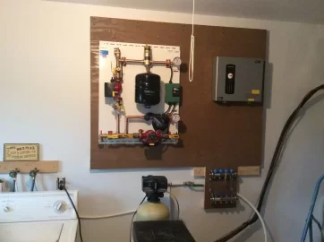

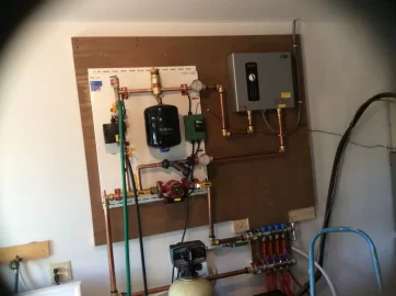

I purchased a hydro smart system at menards and filled it yesterday.....ok, had plenty of questions, but all were answered by friends and through someone that installs them (he is referred to me from menards). Well all went well u till I ran the system....air started to accumulate and the micro boiler shut down because of flow......I entered more fluid until air gone.....then heard sounds I did not like......looked under bath tub where I had previously jack hammered the hole in floor for more room for the tub drain.....found damaged tube of pex O2 .....long story....house was flooded in 2013.... Slab on grade......insurance paid for raising house above flood plain.....installed tubes while pouring new floor( was talked into it by contractor) paid out of my pocket......took two years to finish rest of heated floors( did all myself to save money).... I think the pex can be spliced by a good plumber.....then I will try again to purge air and run that baby!.....I will still have many questions though.....for one, I'm using sump pump instead of transfer pump....that said no sump pump, but I was told it would be fine.....could not get pressure more than 12 psi, but with leak, no wonder...And thanks for the reply!

you probably didn't get all the air out of those floor loops. it'll take some time and opening them one at a time, then all together.
piping looks OK. the sump pump will not push more than 12 PSI usually, as that equates to 27 feet of lift. a 1/2hp transfer pump will usually run easily to 35 PSI (and pop the pressure relief) but will move air out much more readily at 20 PSI. Patience and pressure. your friends in air elimination.

Hey Carl, thanks for the reply.....I found out why I lost pressure....looked behind bath tub where the drain goes into cement floor....the pex is exposed there and it was damaged .....probably when plumber cut the excess off and hit it with saws all....I had to jack hammer hole bigger to expose more pex....hired plumber to splice...did not want to take chance here....been 3 days....still waiting for plumber....must have patience....then was told by plumber to use city pressure after I fill to get the psi up to 15 lbs....very carefully....but when I unhook the pump to re hook city, will I add air?
there are tricks, like purging the air out of all your hoses and putting the fittings on loosely at the heating connection, and turning on the tap slightly to remove all (most) air. I do that sort of thing when I have to add antifreeze to an existing system. it's a pain, and a little messy, but worth it to not have to bleed air out of the system again.

OK now:
Is there a shut off valve for each loop to separate it from the heating system?????
What you do is shut the other loops off completely and then you can power purge the
air from the loop into the boiler then out.
Your plumber took shortcuts by not installing boiler drains and shut off valves to each and every loop!!!
Adding a shut off valve on one side of the manifold and a boiler drain to every loop on the delivery side also allows you to push all the air out with a garden hose connected to a laundry tub faucet with a drain hose going into a bucket or floor drain.

Yes Leon....there is shut off for each of the 4 loops.....I purge one at a time by turning on the pump and watching for air bubbles coming out of bucket, when they stop....I close outlet valve first....wait for pressure to get 15psi, then shut inlet valve....then start on next loop until all loops purged....if not enough pressure, ( been told to raise sump pump high in air so it can achieve more pressure), then I will attemp to use city pressure with Karl's idea of making sure there is no air in the fill hose and keep fitting loose , let some water leak out then tighten.....carefully turn on spigot until 15 psi, then shut valve....will try this week end....by the way, my plumber told me he had propylene glycol and I could buy some....I went to get 5 gallons.....found out he wants the 30 $ a gal!.....I can get at menards for 16$ a gallon! Same stuff full strength. And thanks Karl and Leon for the info!

System up and running....temp on micro boiler set at 105 degrees....pressure is at 30 psi on lower gauge and 20 psi on upper gauge .....thermostat runs in 20 minute cycles....no air in system....I think it's going to be fine....slab on grade house....1200 sq ft.....so far so good....thanks for all of the input from all of you....this is hydro smart system I bought at menards....happy so far. Any body else here use the hydro smart?
