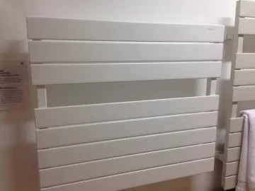

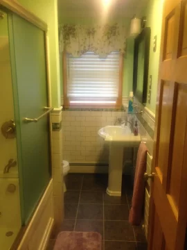

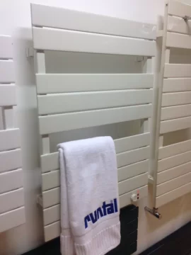

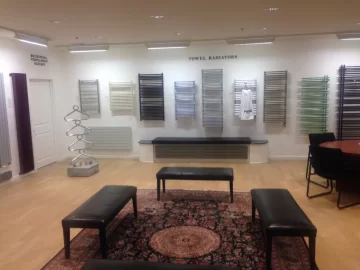

We decided to go with the new modern white powder coated Runtal OmniPanel (Glycol Filled Electric Towel Warmer)
The powder coated radiate better heat than stainless steel or brass!
Click pics to enlarge

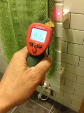

Pelpro pellet stoves do not put out more than 130 Degs but I just got 151 Degs F out of our new glycol filled towel rack! It goes up to 180 Degs F like the water in a hydronic system when fully warmed up. See pic.
Click on pic to enlarge:

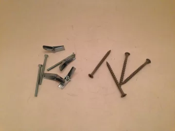

Just wanted to show the skimpy toggle bolts that the heavy towel rack comes with. Sure they are easy to screw in but how sturdy are they?
I just threw them out and installed 3/4" plywood between the studs before the sheet rock and tiles went in.
Then I used these Galvanized Deck screws! That rack will never get loose or fall now!
See pic, click to enlarge
