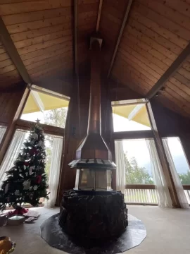

We also just moved into a home with a 1970’s Malm Imperial Carousel Fireplace and it’s so drafty! It’s the only heating element in the home and would like for it to be efficient to do its job! Id like it gone but everyone says we should keep it cuz its cool…thoughts?
[Hearth.com] Heating with a Malm Imperial Carousel
It's a very cool stove for looks, but not the best for heating. A ceiling fan or two would help circulate the warm air that will pocket up at the ceiling peak. If you want to keep it, then maybe add a mini split heat pump to the room.
