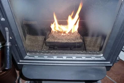

I have been dealing with this heavy ash build up and a lazy flame for the last two winters. It happens after the stove has been running for a couple days straight or more. I usually just shut the stove down and scoop out the ash, and then restart it. Is this normal? I have used Pellets from B.C. which are a little softer , as well as pellets from the Midwest, doesn't seem to matter. Here is a picture for reference to what I am talking about, took it this morning.

I'm curious on the responses here as that flame looks ok to me if it was on low-medium heat cycle. My flame goes much lower than that when in maint mode (room temp/manual).
When the unit is calling for heat, the flame will build from almost nothing and get very large and intense- sometimes getting close to the heat exhange for a short period. Does yours get larger at any time?
I will say that I dont get that kind of ash build up, but I tend to clear the ash at night and also do a quick burn pot scrape in the morning. Maybe I am just not allowing it to build to that level.
I also have not hit a real 24/7 burn for more than a few days yet. Been running for 2 days now, but shutting down today or tomorrow as the temps are rising into the mid 60's again during the day.
Are you scrapping the burnpot daily?
Right from the manual.
Scraping the burn pot:
Whenever adding fuel to the hopper, take the time and scrape the grate surface of the burnpot, using the scraper tool provided. This can be done while a fire is burning. Wearing heat resistant gloves, open the firebox door. Scrape any accumulated ashes from in front of the fire, into the ash pan. Now, scrape under the fire, in a downward direction, to loosen any carbon deposits. Do not scrape the fire out of the pot. Whatever you loosen will be pushed out with the flow of new fuel into the pot.
I would also make sure on your next cleaning that all the holes in the burn pot are clear. Use a probe to poke the holes clean. Also clean arount the ignitor area.
Not sure what pellets or how long it was since that last clean/scrape, but with my XXV the flame will get lazy if I don't give it a quick 30 sec burn pot scrape morning and night. You do seem to have a bunch of ash in there though. How many bags have you burnt?

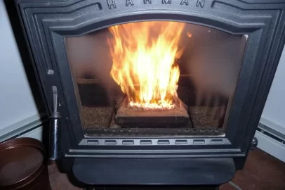

I scraped it clean on Wed morning, its been running since, i have burned 3 bags since Wed. I did not know that the burn pot needed scraped every day or when you add a bag of pellets, thanks for that tip. Here is a pic right after I scraped the burn pot free of ash, and of course the stove is trying to reheat the living room, so the flame is much bigger than in the first pic.

As to the opening of the door and scraping the burn pot while the stove is running, does that stove have to be turned way down? I normally shut it down to let the fire get smaller then when its real small , I open the door and scrape the pot.
Looks much better, I think you will have better heat output if you stick to scraping the pot daily. I know it makes a huge difference with mine, I just wish I had realized sooner that I needed to scrape it daily. Good luck.

That looks better!
You may also need to do it at night too. The more pellets you burn the more it will need to be done.
Keep it clean and it will keep you warm.

Nope just open it up while its running scrape out the ash in front and down the sides, and scrape under the pellets that are burning. I have never turned it down. Your hand might get a little hot, but its not bad.
Now that's the type of flame that makes you smile !!!!!!
Thanks for the info folks, guess it was just operator error. I could not find anywhere in the manual where it said that you could scrape it while its running, but doing as you all have suggested is much easier than shutting the stove off. Thanks for the info.
