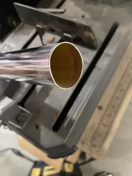

The inexpensive plastic connector pipe really does not last. The so called heavy duty 22 Guage plated brass lasts longer but that is the one I had and it just failed! It rotted on the inside under the elbow and developed a leak! I tried to tape it with flex seal temporarily but when trying to smooth down the tape I heard it Kringle and it just disintegrated!
That did give me an idea!

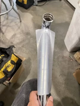

I purchased a new plated brass pipe at ACE hardware because Home Depot does not seem to have them anymore. Their web site said $39.99 but our NH store had one left for $23.99. Then I went to Rite Aid for the Clear Flex Seal Tape for $15.09 which seams to be about the cheapest. Back in my workshop the metal chop saw and angle grinder I cut the pipe to the same length as the old one, then taped it up good with the flex seal and slipped it in.
Do you think the flex seal may possible stretch the life a little bit when the brass starts deteriorating?

Interesting setup. If you think sch40 PVC is the answer (and it likely is) - then why not just build the pipe out of PVC? I think they make fittings for everything you need there. My main thought with the flex seal is that it is on the outside, so once it comes time to need it, the damage is already done. Maybe it would give you just a bit more time to see the leak, but doesn't seem to be an absolute fix. Maybe if you had the spray and shot some on the inside of the pipe?

So the flex tape just might make it better.
Hello
Since Phil Swift could make a boat with chicken wire and flex paste, even if the pipe rots then flex paste may still hold up?
