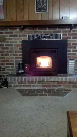

Hello all.
Recent reader first time poster.
Winter is starting to show its head in ohio, at least the worst of it. I've recently installed a harman p35 insert in my house. Single story, about 1500 sf. It's been cooking for about a solid week now (installed myself. Took longer than expected for an inspection) I've went through about a bag to a bag and a half a day set on 65 degrees on stove temp mode. From what I can tell that's about right on par. It's kept the main family room and kitchen at a comfortable 70. Dropping down to 65-68 as you go back the hall to bedrooms.
Today my BIL told me to try using my central air (located in the attic) to recirculate the air to other rooms of the house with the just fan only setting. Only been trying it for a few hours now. Anyone else had luck with this method?
Thanks in advance and really enjoy reading what you folks have to say here, a lot of useful information.
Tyler
Welcome to the harman gang.nice choice on the p35. I use my central fan to distribute the air as well but cool air on the floor get several complaints from the family so what I've been doing is turning up the temp a bit on the stove so it's a little warmer in those other rooms leaving the stove fans on high seems to work better that way.

Looks great!! Nice job

Right now I have my probe off to the side of the stove about 5 feet. Not quite ideal, but gives an ok reading till I get everything all figured out. As of now the recirculating fan is losing a few degrees back to the bedroom, leaving it about 64. I've got all the baseboards off tonight to see what the stove can do. I'm home alone tonight. (Significant other is off with her sister black fridaying, I refuse to partake) so no complaints if it gets a little chilly.
I can't take all the credit for the stove installation. My brother helped quite a bit, he's a contractor so he had insight on things I would've overlooked. The tile was all him. I am not a mason by any means.

Welcome to the Harman family. Your stove setup looks great! It will take a bit of playing around to figure out the best method of circulating the heat, but there are plenty of great people here to help you out!
