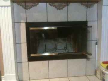

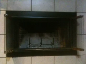

Thanks for the quick reply! I don't know if it is a zero clearance, how do I tell? I do know that it has about an inch of open space between the interior and exterior walls of the actual firebox (forgive my lack of proper terminology). Here are 2 pictures of the fireplace. The dimensions of the opening (of the tile surround) are 39 1/2" wide, 25" high, and 18" deep, to the back of the inside box.
Thanks!

yep... that's a ZC fireplace. "Factory built fireplace", "zero clearance fireplace", & "metal fireplace" pretty much all refer to the same type of fireplace. You'll have to make sure that whatever insert you choose is approved for installation into a ZC fireplace. Another concern I have is how you're going to support the insert with a fireplace opening that high off of the hearth...
Another option, though more expensive & time-consuming, would be to rip out that ZC unit all together & replace it with a high-efficiency ZC fireplace, such as a Fireplace Xtrordinair or Heat N Glo North Star.

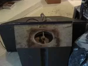

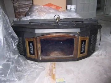

Thanks again to all, this is great info for a newbie! Yes, the fireplace is in the main living area, and I feel the same, I'd rather have the bedrooms a little cooler. I have a line on a unit for sale locally, for $300. It could use a little spit and polish, but it isn't that bad. The only thing they can tell me is that it is an "Earth Stove" brand, and it's the "Majestic Line" It does have a blower, and it looks like it protrudes about 8-10 inches in the front. It is REALLY wide, but the part that goes inside is 29 3/4" wide X 29 1/2" high X 16" deep. Firebox size 18" wide X 21 1/2" deep. Bigger than my current surround, but that's being demo'd anyway. It flares out at the sides, which is where the vent outputs are. Here is a pic. Needs some paint and brass polish, but for $300....... I searched for info on this unit as far as BTU and blower CFM, but didn't find anything. What do you all think?

that is an insert, & if you're tearing out the entire fireplace (like you said earlier), then you should be looking for a new ZC fireplace or free-standing stove, not an insert. Inserts are designed to be installed inside the firebox of an existing fireplace.

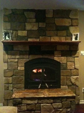

Hi all! I know it's been a while, but I thought I'd update y'all anyway. I found a new, never been installed Heat n' Glo Northstar on craigslist for, get this, $2500!! I talked him down to $2200, and found a licensed installer who will do the technical part of the install for $500, and leave it for me to enclose. This includes tear out of the old unit, and installing the new unit and liner, and making all of the connections. All I have to do is install an outlet for the fan to plug into, and build the raised hearth, mantle, and the rest of the stonework.
Thanks VERY much to EVERYONE here who helped me get to this decision. I know this unit will provide plenty of heat to keep us toasty!
Just remember.... If there's no pics, it never happened! :cheese:
OK, finally finished it on Christmas Eve, the very day that 9 of my wife's family arrived, so I hope you'll pardon the delay. Been a little busy. With the exception of the actual fireplace installation, I did everything myself. Plywood, then felt paper, then metal lath, then scratchcoat, then mortar the stones to the wall, then grout it. Overall, I'm pretty satisfied with how it turned out. I have a few pictures of it during the build, but not really a full blown how to. I'll get those pictures up when I get some more time. This isn't the greatest quality picture, so I'll also get some better ones to post.
I absolutely LOVE this unit, so a HUGE thanks to everyone for all of the advice. It puts out a ton of heat, and looks nice, too. I like the fact that you can burn 24 inch logs, though it makes it hard to get the full length of log going. I am going to cut future firewood at about 18-20 inches, to make them easier to load and arrange. I am getting a lot of buildup on the glass, but a bit of research told me that the wood is probably a little too wet. I haven't gotten around to buying a moisture meter yet, so I don't know for sure.
Again, thanks for everyone's advice, and please, PLEASE, let me know your honest opinion of how it looks. I think it's pretty good, considering this was my first attempt at any sort of masonry work. I had never even mixed mortar before this job.

Wow, that is a stunning finish! It looks fantastic. That has to be a source of a lot of pride and joy. Aren't you glad you didn't stick that old Majestic in there now?
