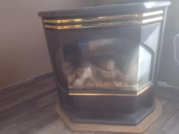

Hey everybody! First time poster, just trying to troubleshoot a gas stove that doesn't like to respond to the thermostat unless I jiggle the wires that attach to this black box (pictured) I gather that this device some how causes the main gas valve to open when the thermostat sends the signal - but I can't for the life of me figure out what this is or how to find troubleshooting advice/replacement parts for it.

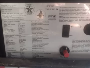

Picture of the stove and nameplate also attached for reference.

The rating plate is confusing. It labels the unit as gravity and
fan-type Direct Vent. Gravity type is B-Vent & is different from DV.
I'm thinking since that component is rated for VAC, it's a Low Limit
switch for the blower.
