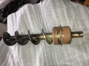

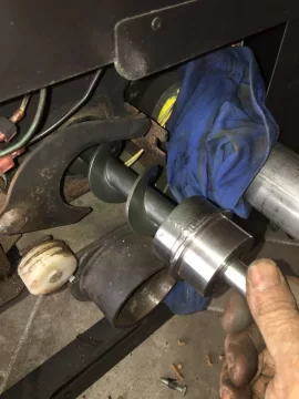

One more item I highly recommend!
I changed all the motors in my Harman Advance and then a few days later my auger jammed right up!!! No foreign objects and I was burning very good pellets. So I pulled the auger and 3/4 of it was black with pitch and the rest was dirty, stick and rusty! So I buffed it out with my wire wheel on my drill driver and sprayed it down with "Dry Moly" then I put it back it and it is working like brand new!
PS - Make sure the auger bearing turns freely or you may need a new auger.
See Harman Advance Auger Below:
Click on pic to enlarge

Hello
Just made a video on the "Spin Test" to check your Harman Auger Bearing.
Thanks Don. I'll inspect the Auger also.
