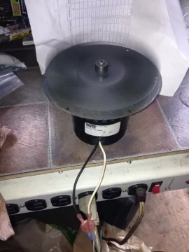

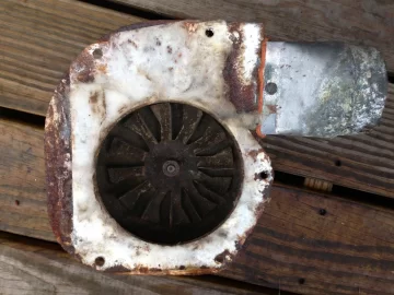

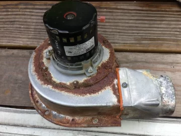

This blower housing was in tough shape! So I took out the motor.

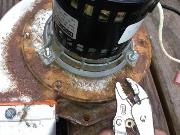

All but one severely rusted housing bolt came out after wire brushing and soaking with the PB blaster. The last bolt took the air cutter to cut the head off and then drill out the threads and tap a new bolt in.

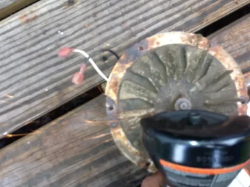

All but one of the rusted hub nuts came out easily, the last one need the vise grips to give it a little push.

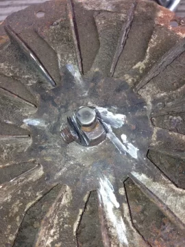

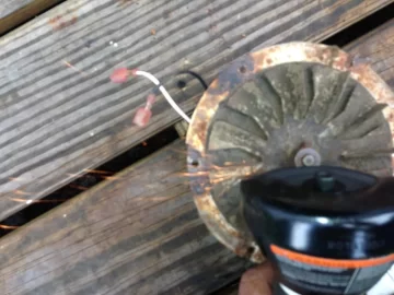

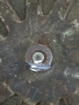

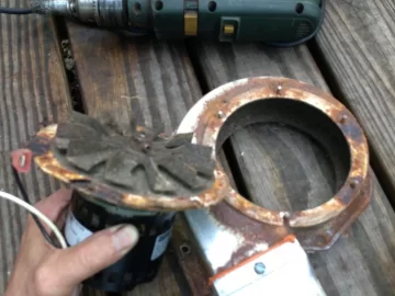

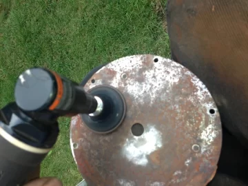

The impeller collar was rusted solid and the wire brush and PB Blaster did no good, the allen wrench just stripped the set screw. The air cutter did the job again! See pics.
Here is a video of how the motor sounds.
Does anyone know where to get a 4-3/4" impeller blade cheap?

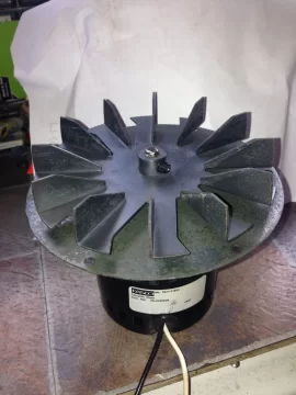

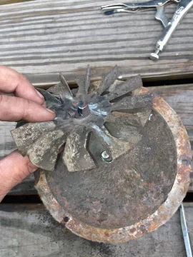

In the meantime, I did find one in very good shape off a junk motor. I did not have an extra hub so I pulled out the Wire Wheel, Die Grinder, Acetone and Dry Moly Spray to see how this rusty mounting hub would cleanup? See pics, not bad!
I would never sell this as new, but it makes a good spare to pop in a stove that dies in Mid Winter till a new part arrives! ! !
