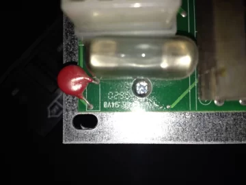

I've got a Lopi Leyden with a burnt-out controller board. Or I should say a badly fried capacitor on the board. If anyone has a similar stove and could tell me the writing on the part so that I can possibly replace it instead of ordering a new $250 board, I'd really appreciate it. Either the numbers on it, or a nice clear picture of it would be wonderful. The part in question is a round (disc-shaped) red capacitor, on the corner of the board immediately adjacent to the fuse. Apparently this bit is the first line of defense against a large power surge. :)

Hope some one with your stove spots this ... Welcome to the forum! Sorry to hear about the power surge... pic of the board might help.

Too hard to see what's on the cap. It's pretty small round, flat, ceramic & letters faded- looks like maybe 130? Maybe try calling Travis and ask a tech what size/voltage the cap.

Hi Brian,
Travis Industries always recommends replacing the entire board. If we do replace just one part of it we run the risk of the appliance losing its listing and becoming an "illegal" unit.
