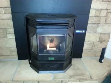

Pics would probably help to show flame quality, control board and we just like pics of stoves in general:)

Here is a pic of the stove on P1, pardon the glare its very bright out today. This is with the 4 on and 4 off with a blower speed of 170 and convection fan of 100.
  • [Hearth.com] Help with a Ningbo Grace Pellet Insert.

Yep, 13kw is 44k btus. As for low, staying inside the burn pot, that's pretty typical. The picture of 4 on/4 off, seems a bit low though.
Really like your hearth - love the stone. How much was the stove? Sounds like your stove guy needs to gain a little experience with the stove himself... You'll get there with a little experimenting with different levels and different pellets. If your manual is like most, it may not be as helpful as you'd like ... Hopefully a few will chime in with helpful hints.
