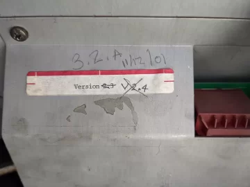

The stove is up and running after installing the repaired main circuit board from Joe.
Great guy and thanks to Bob for his contact.
I believe the low limit switch is bad as the stove shuts off after 15 min but keeps going with a jumper on the switch.
The flame is a bit lazy compared to my Wega and wondering if anything can be done about that?
![[Hearth.com] Help with Austroflamm part Identification [Hearth.com] Help with Austroflamm part Identification](https://www.hearth.com/talk/data/attachments/286/286161-551e937107d9cf23d4e3da4eef9f4d58.jpg?hash=umd1ItwP8V)
