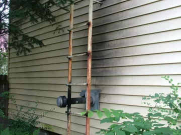

Hi everyone, I have a England 25- PDVC pellet stove. It seems to be burning dirty. I clean this thing top to bottom about every other day. With winter just around the corner
how can I fix this? Any help I would appreciate.thanks , Todd

Do you have any Vertical Rise in your flue? Looks like a Direct vent (just Horizontal), unless that is a High Exiting Basement install??
Englander recommends at least 3-4 ft of Vert for Draft. That would help a little.
Also what are your bottom 3 settings (LBA-LBF-AOT) on your Control board?
How old is this unit? Did you buy it new?

If its a 2005 or newer (per the link thread below)
LBA- Low Burn Air ----- 6
LBF- Low Burn Fuel ---- 4
AOT- Air On Temp ---- 1
Look at this https://www.hearth.com/talk/threads/23846/
Also you need Vertical rise. Look at your installation/Owners manual. Its in there.

As others above have noted, that stove is burning VERY dirty (rich), as evidenced by the coating of what looks to be creosote on the cap.
You say you clean the stove every 2 days.....a real cleaning is NOT just cleaning out the firebox. It involves actually dismantling as much of the stove as possible......removing blowers, augers, etc, etc, and cleaning all the ash traps.
Also, since you have a direct vent set-up, it would be VERY easy to use a leaf blower on that stove (after the above-mentioned complete cleaning) to get every last bit of ash out.
Bottom line....that is a dirty stove.
Also is that termination cap for a horizontal vent installation?
Looks like a vertical termination cap but it is hard to tell from the picture.

Good question Smokey. Looks like a cap for a vertical install to me.
Couple of questions for the OP....what year is the stove, and what are lower button settings? Has the combustion blower ever been removed
and cleaned? Has the OAK tubing been checked for any obstructions (bees nests, mouse nests, etc, etc)?

No Vertical Rise = No Draft. You are relying on the combustion blower itself to exhaust all of your flue gases. I will say it again. You need to install a 90 or a Clean-out T and put a Vertical Rise in your Venting system. Also take apart the Combustion blower. Clean inside the area really goo, lube the motor (if it can be), and adjust the bottom 3 buttons to factory specs. If you are still getting soot. Then email, call, or PM Mike Holton (Forum member/Head tech at Englander) and he can further assist you on making the correct adjustments to resolve your Sooting issues.
Clean the Stove "Really Good" and put a 3-4' ft rise in your venting. That alone will help a lot.

I think your stove is burning poorly, which is why you are getting the accumulation on the siding. As already stated, a very thorough cleaning is indicated.

My Quad is Direct vent also. My siding is Crystal Clear. Englander recommends a rise in the flue. Either inside or outside. The bottom 3 buttons (adjustments) are for fine tuning the stove. But "Majority" of the time. The factory settings are ideal to run in most applications.
As imacman stated doing the "Leafblower" Trick on that stove, along with blowing compressed air from the inside (After a Full cleaning), will "Clean" it up.
1.-Clean, then Leafblower and Compressed air
2.- Reset Factory settings
3.- Install a 90* or Clean-out T, add 4 ft of Vert flue
4.- Sit back and watch the Fire
Is your flame "Lazy"?? Cleaning and lubing the Combustion blower may help a lot also. If its never been takin off and properly cleaned, there is a build-up on the blades. Which would put a rotational resistance on the motor, which would also lead to a bad burn.
Just a few ideas. Take it or leave. But..... I have just over 5 ft of Vertical on the Englander in my Shop. Burns like a Champ. No sootiong on the siding there either. Just my 2 cents. I think those 3 things would help tremendously. IMO

Bottom line: the outside creosote covered exhaust cap tells the tale....dirty stove and poor draft because of the direct vent w/o any rise.
All that vegetation so close to your house doesn't help either.
