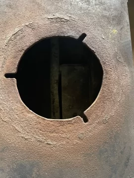

Hello
Just looking for a little advice/direction
Haven’t had any luck trying to find a replacement kit or collar for this, the one that was with the stove has the bolts sheared off.
Any help on where to look or what I should do would be appreciated.
Thanks
[Hearth.com] Heritage 24 flue collar [Hearth.com] Heritage 24 flue collar [Hearth.com] Heritage 24 flue collar [Hearth.com] Heritage 24 flue collar [Hearth.com] Heritage 24 flue collar [Hearth.com] Heritage 24 flue collar

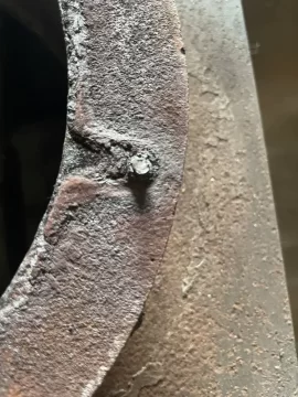

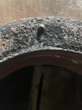

Could the old ones be drilled out and replaced with new through bolts?
Reactions: MJS11
That’s what I’d do. Go slow and use lots of cutting oil.
An alternative would be to grind it all smooth, mark out locations, and drill new holes
Reactions: MJS11
Thanks for the advice guys! I have drilled the old one out, what type/material of bolt would you use to stand up to the heat?
Stainless will do. Put a bead of stove and furnace cement on the rim face before bolting it down.
