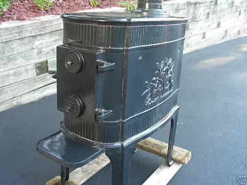

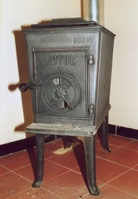

There was earlier basic introduction of secondary burning in older stoves. You will see upper, secondary air ports on the doors of some old stoves. Lange comes to mind here. But even the basic Jotul F602 from WWII had a basic secondary burn. It's baffle + double ported, spin wheel draft control introduced air at the bottom of the fire and at the top of the baffle where the fire was making its turn so that secondary combustion would occur in front of and over the baffle. Cawley-LeMay, Upland and others copied this design. IIRC even some old parlor stoves had a basic top air port to promote some secondary burning.
