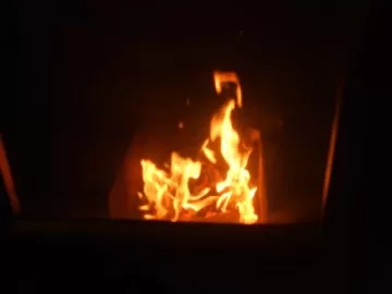

I'm thinking it may be the blower as well I got the stove going again and I'm running it on 6-9 take a look at the attached photo thats the flame in the stove right now. Usually I can't hold my hand in front of the stove when its on 3-6 for or even 2-5 for very long. The heat coming out of the stove right now is so low that I can have my face about 8 inches in front of the stove with the air blowing right on me and I don't have to take my face away.
I think I'll load the old hog up and take it back for a replacement tomorrow. I'm definitely not giving up on Englander, I really like the stove. Can't make a perfect product every time. :)
EDIT: Photo is 6-9 not 9-9 sorry about that.

Flame definitely seems small and lazy, but it's tough to tell from just a picture.
If it's a new stove and you can return it, I would. If it's under warranty, return it. That's what a warranty is for.
